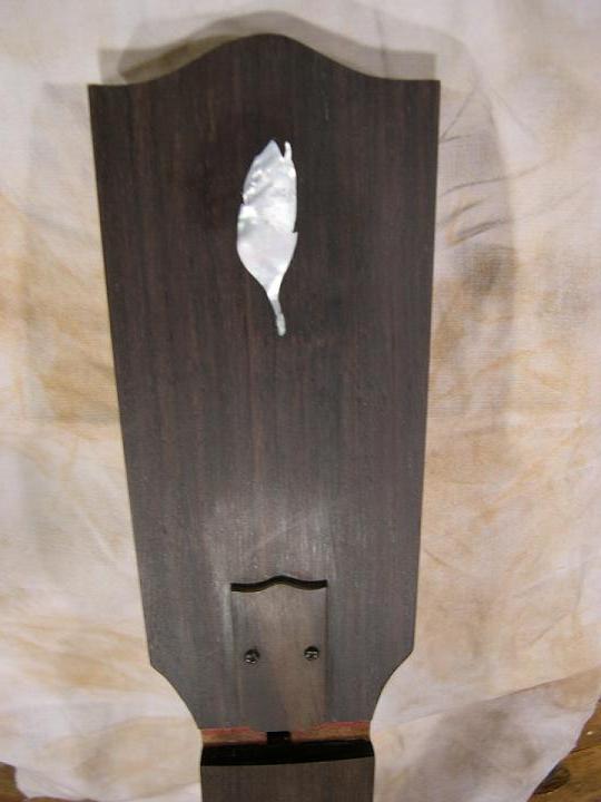

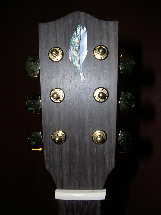

I've done both ways but prefer the access to the truss rod via the headstock. For me this makes it easy for final set-up and any future adjustments.
I basically exit the channel via the headstock as so.
Here are 2 images with and without a cover.
Michael Lloyd

I just pre-tap the holes than tighten to finger tight. Not much pressure at all. As fore wearing out I've haven't had any issues. I generally don't have a reason to take the cover off that often maybe once every 2 - 5 years and only if the truss rod needs adjusting which maybe never.
